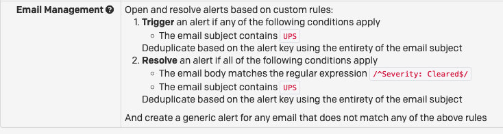

This sends an email to Pagerduty with the same subject and the email body contains the string ‘Severity: Cleared’ as shown below
For some reason the incident is not being resolved.
I hope that someone can help me to work out why it’s not working.

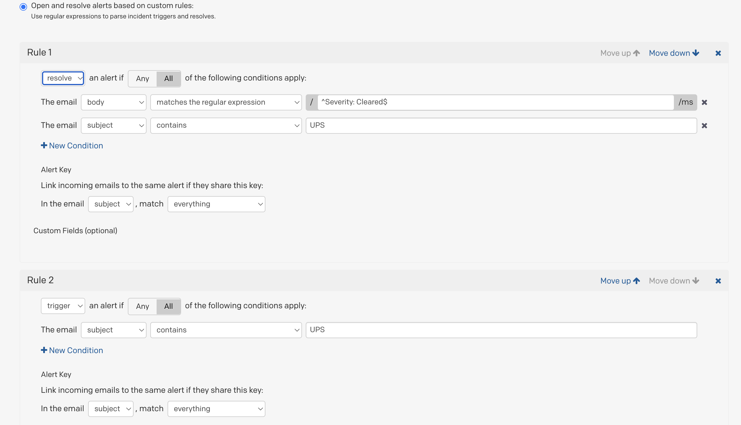

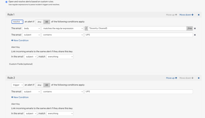

I just tested the integration - successfully - with the configurations you sent on the first message…with one slight change that totally makes the difference. I moved the resolve rule to first place to take precedence over the trigger rule. Since you are using and matching the subject as the key in both rules the first one would always match. Which means that the email would be always matched with the trigger condition and get associated with the first alert, instead of resolving it.
If you invert the order we check if the subject is a match and the body matches the pattern. If it doesn’t then you consider it a trigger. See image below.
Let me know if that solves the issue for you.
Hi @tiago.barbosa,
when you explain it like that it makes perfect sense.
It works now.
Thank you for your help.
